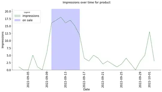

I am working with product data for a retail company. I have the daily impressions (number of times it was viewed online) for all products over a 30 day period (can get more data).
Here is the data for one product:
on_sale = [False, False, False, False, False, False, False, True, True, True,
True, True, True, True, False, False, False, False, False, False,
False, False, False, False, False, False, False, False, False, False]
impressions = [1,0,0,5,1,0,6,16,17,18,16,17,15,12,4,3,5,4,2,3,2,1,2,4,2,0,3,5,13,3]
So this product was on sale from index 7 to index 13.
We expect that when a product is on sale, it will see an increased number of impressions.
