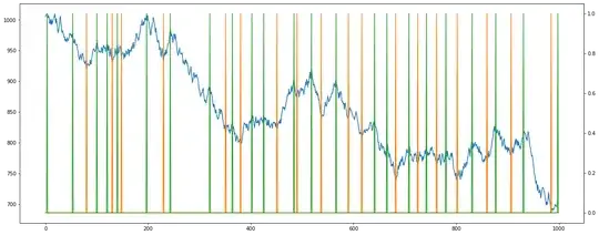

UPDATE: An example for illustration:
  • A peak is identified at 1000
  • The next valley that can be identified must be >1050 or < 950.
  • It is ok for two valleys (or peaks) to be identified in succession (same as with argrelextrema). You can see examples in the attached chart.
