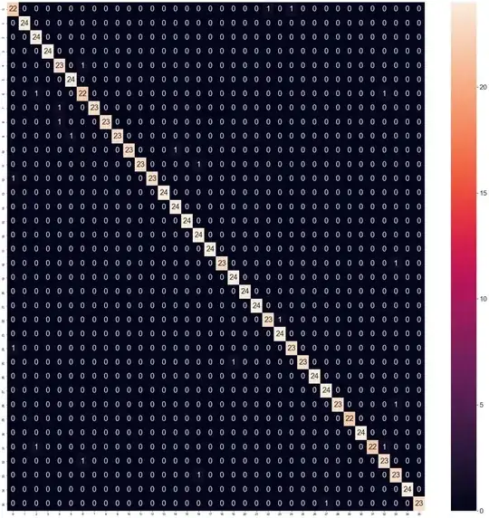

How do I add class labels to the confusion matrix? The label display number in the label not the actual value of the label Eg. labels = ['A','B','C','D','E','F','G','H','I','J','K','L','M','N','O','P','Q','R','S','T','U','V','W','X','Y','Z']
confusion matrix image
Here is the code I used to generate it.

You can use the xticklabels and yticklabels arguments for this as specified in the seaborn documentation. See also the following answer on a different question on the datascience stackexchange.

You can first define your labels an use that in xticklabels and yticklabels values.
import seaborn as sns
from sklearn.metrics import confusion_matrix
from sklearn.neighbors import KNeighborsClassifier
from sklearn import metrics
#defined your labels labels = ['A','B','C','D','E','F','G','H','I','J','K','L','M','N','O','P','Q','R','S','T','U','V','W','X','Y','Z']
you have already trained your model and obtained predictions
Print confusion matrix
cm = confusion_matrix(y_test, predictions)
Plot confusion matrix with class labels
plt.subplots(figsize=(30, 30)) sns.set(font_scale=2) sns.heatmap(cm, annot=True, xticklabels=labels, yticklabels=labels) plt.xlabel('Predicted') plt.ylabel('True') plt.show()
