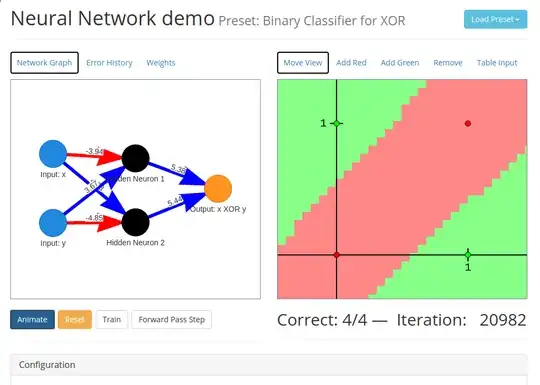

Without code you could have made to many mistakes to answer your question directly.
However, I suggest two things:
  1. Gradient checking (e.g. this explanation, but there are many more - pretty sure also in the course)
  2. XOR problem with a 2:2:1 network with only sigmoid activations. Plot the error surface. Compare the decision surface with that of this interactive demo.
It should look similar to this: enter image description here
However, please keep in mind that the problem might not be your implementation, but rather the network architecture / hyperparameters such as the number of epochs you're training or the training data.
Also, very important: I doubt that you will get good results for $y = x^2$, except if $x$ is restricted to $[-1,1]$ or something similar simple. Please keep the domain of your output layer in mind.
