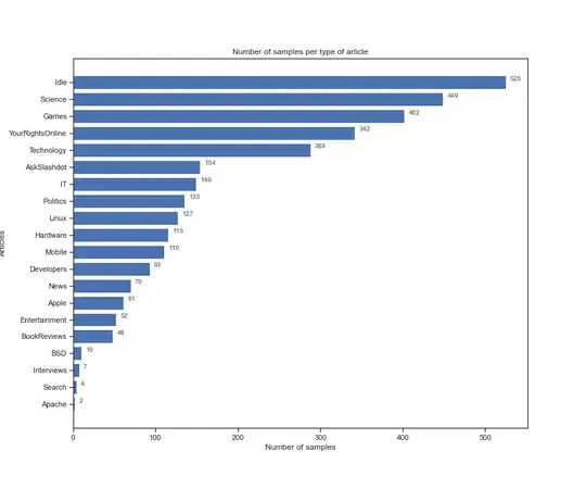

As you can see from the above snippet in the first 22 columns I have my targets (i.e. type of articles) and the rest of the columns belong to my word predictors. The values of my features are binary, i.e. «1» if the word appeared on the blurb, and «0» otherwise. First, I do a little of preprocess and I separate the targets from the features, I change the boolean values that correspond to the targets to 0 and 1 and I give Labels to my articles (i.e. 0:«Entertainment», 1: «Interviews» etc). In the following snippet you can see the distribution of my samples according to each different type of article.enter image description here
As you can see from the above image, my dataset is unbalanced. My aim is to try the following classification algorithms and choose the best one at end: 1) GaussianNB (GNB), 2) KNearestNeighbors (KNN), 3) LogisticRegression (LR), 4) Multi-Layer Perceptron (MLP) and 5) Support Vector Machines (SVM). Before I start to preprocess my dataset in more detail I split my dataset on 70% train and 30% test and I do an Out-of-box-test of these algorithms, in the following table you can see my results

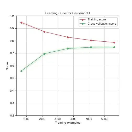

To give you another view of the above result below I can show you the learning curve of the GaussianNB on a 10-fold cross validation in the second case where I first do the oversampling and then the splitting.
As you can see from the above snippet the validation score and the training score converges on the same number which is a good indication that the model can achieve a good generalization performance.
