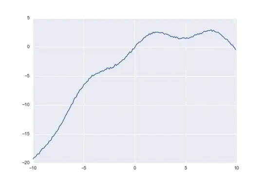

y = -0.1*x**2 + x + numpy.sin(x) + 0.1*numpy.random.randn(len(x))
Arbitrary function

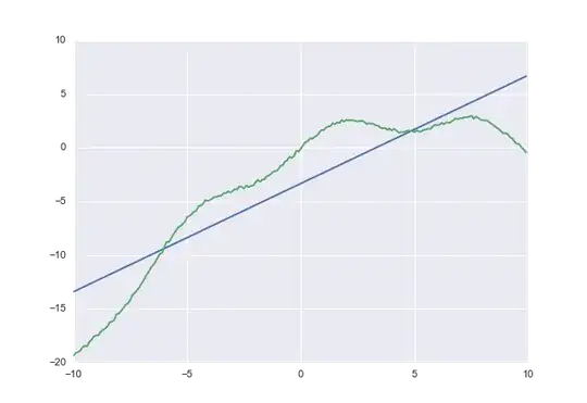

If you use cost you get
1.00764 -3.32445
cost

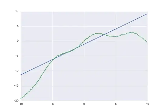

If you use acost you get
1.02604 -1.07742
acost
acost clearly tries not to underestimate. I did not check for convergence, but you get the idea.
