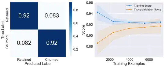

I get the following confusion matric and learning curves (based on this link):
Notice that the cross-validation curve exceeds 90% when training includes all samples. However, when I got to the (pre-processed, imbalanced) test set, I get a significantly lower recall score around 79%.

Training on the resampled data causes the model to assign roughly the same proportion of positive and negative labels, especially in difficult cases where it doesn't have clear enough indications from the features.
When testing on the test set with the original distribution (this is the correct method of course), the model applies what it learned: for "difficult cases", it assigns roughly half positive labels. But the test set has a higher proportion of positive cases, so this results in more false negative errors and therefore lower recall than on the training set.
