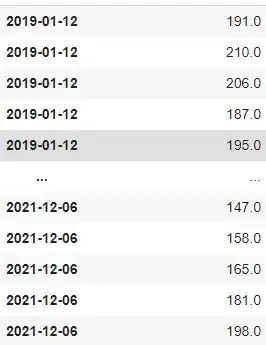

I am using an LSTM model to predict the next measurement of a sensor.
The dataset looks as follows: enter image description here
There are approximately 13000 measurements.

I tried using different learning rates(0.01, 0.001, 0.0001), more layers (1-3) and/or more neurons(1-128), epochs(40-200), I changed the training size (67-80%). I tried changing the activation function on the Dense layer(sigmoid, relu), I used different optimizers(GSD, Adam, Adagrad). I added Dropout layers, but that didn't help in decreasing the RMSE.
The RMSE doesn't drop below 6.5, the lowest value seen with the following parameters:
  • Train size = 0.8,
  • LSTM Layers = 2,
  • Epochs = 100,
  • Neurons = 32,
  • Look back = 10.
If anyone has any advice on how to get the RMSE to a lower value (as close to 1 as possible), I would love to hear it. I can share the dataset if needed for review.
