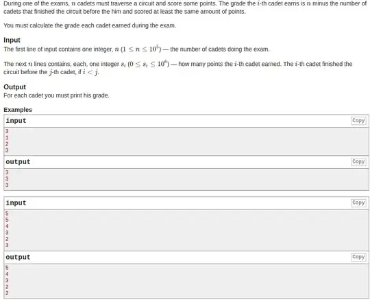

I am new to algorithms so sorry to ask simple question
I am working on a problem which is about array of integers, my solution is right but not good enough, because I have time exceeded exception on codeforces. I think solution where solution's time < O(n^2) would be right.
My solution:
