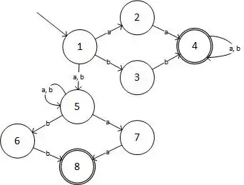

I have a simple problem of making a DFA which accepts all inputs starting with double letters (aa, bb) or ending with double letters (aa, bb), given $\Sigma =\{a, b\}$ is the alphabet set of the given language.
I tried to solve it in a roundabout way by:

Step 1: Regular expression for given problem is (among countless others):
((aa|bb)(a|b)*)|((a|b)(a|b)*(aa|bb))
Step 2: NFA for given expression is:
NFA
(source: livefilestore.com)
In Tabular form, NFA is:
State    Input:a     Input:b
->1        2,5         3,5
  2        4           -
  3        -           4
 (4)       4           4
  5        5,7         5,6
  6        -           8
  7        8           -
 (8)       -           -

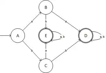

Step 4: Minimize the DFA:
I have changed K->G, J->F, I->E first. In the next iteration, H->D and E->F. Thus, the final table is:
  State    +   Input:a     +   Input:b
   ->A     |      B        |      C
     B     |      D        |      E
     C     |      E        |      D
    (D)    |      D        |      D
    (E)    |      E        |      E
And diagramatically it looks like:
Final DFA
...which is not the required DFA! I have triple checked my result. So, where did I go wrong?

You are fine up to step 3 (the DFA) but your minimization is incorrect.
It's clear that the minimized DFA is not right, because both the inputs ba and ab (which are not in the original language, nor are they accepted by the DFA in step 3) lead to final state E.
Looking at your minimization steps, it seems that you have unified final and non-final states; for example J (final) -> F (not final) and I (final) -> E (not final). Merging a final state with a non-final state changes the language accepted by the automaton, leading to the acceptance of incorrect strings as noted above.
