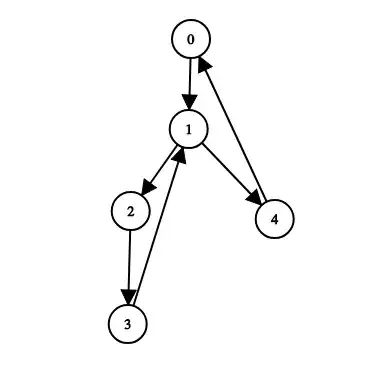

The following example show how DFS order alters lowlink values in this alternative algorithm: Graph In this case, assuming we are exploring vertices in the order 0-1-2-3-4, when we consider the vertex 3, the vertex 4 has not been explored yet. The lowlink value of vertex 1 is so 1, and vertices 2 and 3 will take the same value. But we will later find the back edge from 4 to 0, and set the lowlink value of vertices 4 and 1 at 0. If we had explored vertex 4 prior to vertex 2, all vertices would have 0 as lowlink value.
