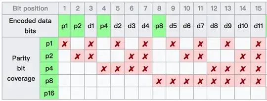

Someone mentioned that "The usual Hamming code has length of the form $2^\ell−1$". For $\ell=4$, the usual Hamming code of length 15 is defined by the following table from wikipedia. If we truncate the last 4 columns, we will get the truncated Hamming code of length 11, which should be, presumably, the Hamming code used in OP's question. table of general rules to generate a single-error correcting Hamming code of length 15
