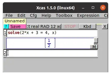

I'm sure you'll find some references by taking a look at how Giac works. It is quite extensive so I couldn't do it myself now. Here you will many useful links. I think you might find something related to your question in the 1109 pages of documentation.
