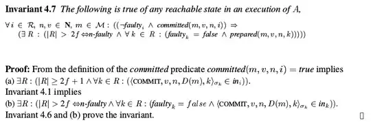

I am reading the PBFT Correctness Proof Paper and I cannot make completely sense of the Invariant 4.7 and its proof: enter image description here
Here are my concerns:
  1. I assume that the symbol $\Leftrightarrow$ is used with the usual meaning of double implication.
  2. $n\mbox{-}faulty$ is defined (Definition 4.3) as the number of faulty replicas, so I do not understand how it can be used as a predicate in Invariant 4.7.
    When is $n\mbox{-}faulty$ true of false?
