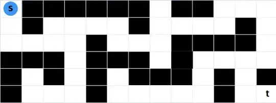

How would I solve the following problem?
You have maps of parts of the space station, each starting at a prison exit and ending at the door to an escape pod. The map is represented as a matrix of 0s and 1s, where 0s are passable space and 1s are impassable walls. The door out of the prison is at the top left (0, 0) and the door into an escape pod is at the bottom right (w−1, h−1). Write a function that generates the length of a shortest path from the prison door to the escape pod, where you are allowed to remove one wall as part of your remodeling plans.
I know that without destroying the walls this could be easily solved with the use of Dijkstra. But how to take into account the fact I can destroy one wall?
The only solution I could come up with was to remember two distances for each node: one distance is the "real" shortest path, the second one is the shortest past when I break one (any) wall.
At first I would count all the "real" shortest paths with classic Dijkstra. In the second run I would use Dijkstra again to compute the second parameter of each node: shortest path with exactly one wall broken.
In each iteration the closest node to be chosen (I need to check even vertices that are "one wall away") in Dijkstra is the one with the shortest "real" path or path with a broken wall (whichever is smaller). In case the vertex is one wall away, I only check the "real" path property of course.
This seems correct to me. But is there a better (more efficient) solution?

You can use any search algorithm (including A*) with a tiny alteration from the standard one.
In each node you store whether the path from the start has a broken wall or not. Then when generating the neighbours you can move into a wall only if that flag is false and the neighbours that move into a wall get it set to true.
When Comparing Nodes for equality (for replacing in the heap and or the closed set) that flag counts alongside the position.

Introduction
While solving google foobar I stumbled upon this problem. I approached the problem with A* along with a few modifications. As this algorithm correctly outlines the core concepts, I would like to go further ahead and add some detailing to this.
Algorithm:
Each node will have the following parameters:
  1. parent: The immediate parent of the node.
  2. position: This is the (x,y) position of the node.
  3. f,g,h: These are the heuristics needed for A* to work.
  4. wall_broken: This is a boolean flag that would account for a broken wall in the path to the node. By default is set to False.
After we set up our pre-requisites, we move into the algorithm.
  1. Create the start and end node.
  2. Initialize the open and closed lists. The open list must contain the start node.
  3. Iterate until we have visited each node.
    1. Take the node with least f from the open list. This is our current node. Remember putting it inside the visited list.
    2. Check whether the current node is the end node. When comparing equality, we will compare the positions of the nodes only. If yes, then hurray! Return the path that has been traced. If no, perform the next step.
    3. Generation of children from the current node.
    • Check for validity of the position.
    • Check if the position has a wall. If it does, then we need to check whether the current node has any broken walls in its path (this is where we will need the wall_broken property of the node). We destroy the wall if we have no prior destruction. We make sure to assign the wall_broken property of the child which broke into a wall to True.
    • We do not generate children if they already have been visited.
  4. Iteration on the children to decide which goes into the open list and which don't.
  • Assign heuristics to each child.
  • Look for a better child in open to replace. Else add it into the open list.
Conclusion
This algorithm is a modification of the A*. It conveys the core concept. If you want a detailed walkthrough of the concept with code, I have a gist written in python.
