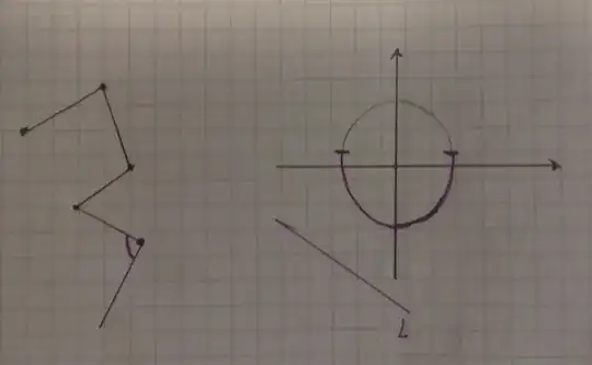

A polygonal chain $C$ is called monotone with respect to a straight line $L$, if every line orthogonal to $L$ intersects $C$ at most once.
I want to design a linear-time algorithm to check whether there exists a line $L$ such that a given chain $C$ with $n$ vertices is monotone relative to $L$, and find such a line.
My idea is to take an angel of monotone chain and transfer it to the unit circle and suppose there is a line L ! like this enter image description here
But I don't know how to find a good solution that the L exist

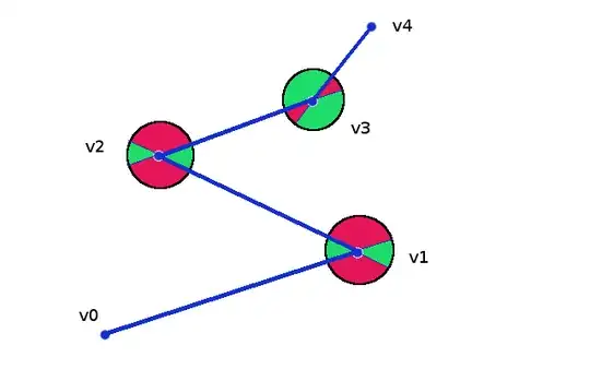

This answer is related to the remarkable answer for a similar problem. The only difference is that the OP asked about monotonicity of a polygonal chain, but not about monotonicity of a polygon.
The algorithm idea is the same - we need to determine ranges of "authorized" angles for normals to $L$ looking at the adjacent chain segments. An angle is considered authorized if a normal with this angle defines such a straight line $L$, that all the straight lines, orthogonal to $L$, intersect the chain not more than once. In case of a polygon it was enough to look at concave vertices only, but in our case we must look at all the internal vertices.
The picture below shows a polygonal chain with four segments. Authorized angles at each internal vertex are marked by green color.
If an intersection of all the $(n-1)$ ranges of authorized angles isn't empty, then the polygonal chain is monotone, and the line $L$ exists. This algorithm apparently will take $O(n)$ steps.
