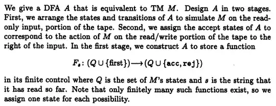

We give a DFA $A$ that is equivalent to TM $M$. Design $A$ in two stages.
  1. We arrange the states and transitions of $A$ to simulate $M$ on the read-only input portion of the tape.
  2. We assign the accept states of $A$ to correspond to the action of $M$ on the read/write portion of the tapeto the right of the input.

  1. Why the domain and the codomain of the defined function takes this form? and why only finitely many such functions exist as stated by the last line in the first paragraph?

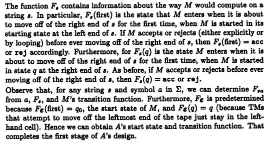

  2. Why the author wrote $F_{\epsilon}$ as in the third paragraph? did he used the idea of epsilon transitions?

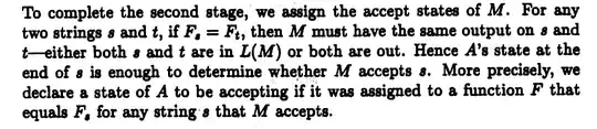

  3. The last paragraph in the solution I did not understand its idea at all?

  1. That is already the reason for the domain and codomain. The domain is everything that matters about entering the input part, the codomain is everything that matters about exiting that part. Hence the function completely describes the behaviour of the TM on the input part. In a sense, the function contains everything the TM will ever find out about the word $s$. Both domain and codomain are finite, hence so is the set of functions. Although the definition is about infinitely many words $s$, there will only be a finite number of different functions $F_s$.
  2. $F_{\varepsilon}$ is not about $\varepsilon$-transitions. And it does not expand the previous definition. It is just the special case $s=\varepsilon$, that is the case of the empty input word. Or rather, the case of the empty prefix. After all, the paragraph where this appears is all about how $F_s$ can be computed incrementally along with prefixes of $s$.
  3. By now we have fully defined the automaton, except for acceptance. And the automaton state fully describes what the TM can do with the word we have read. We have not yet said anything about the part of the TM's computation that happens outside of the input word. The trick is that we do not have to delve into that computation. We just say that the state $F_s$ is accepting if the word $s$ belongs to the TM's language. The paragraph has an explanation of why that is well-defined.
