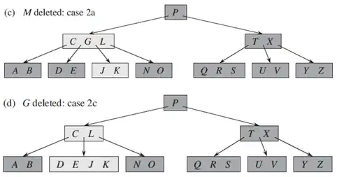

I have a doubt in step 2c. In this step, $y$ is a node containing the predecessor of the key and $z$ is a node containing the successor of the key, both of which has minimum number of keys ($t-1$) and hence authors say we need to merge both of nodes. The authors give following example:
First tree is before deleting $G$, second is after deleting $G$, which utilized step 2c.
Here, $y=[D,E]$ is a predecessor node of $G$, with predecessor $E$ and $z=[J,K]$ is a successor node of $G$, with successor $J$. So we merge both $[D,E]$ and $[J,K]$ forming $[D,E,J,K]$.
My doubt is do we always end up successor and predecessor node if they contain minimum number of nodes ($t-1$)? This is what authors must mean to say when they say "merge $k$ and all of $z$ into $y$" in step 2c. But I feel they might not be the predecessor and successor nodes, they are just immediate next children of key $k$, as can be seen in this example I tried out:
Here we have not merged nodes of predecessor (node $[N,O]$) and successor (node $[R,S]$), but have merged immediate children of $Q$, i.e. node $[C,G,L]$ and node $[T,X]$.
So am I right with "we need to merge immediate next children of key $k$ but not predecessor and successor node"? If yes, is book have mistake? Or book does indeed tries to say the same and I am misinterpreting? Or I got it all wrong? Or am unnecessarily overthinking?

You are probably overthinking it by thinking in terms of predecessor/successor nodes.
The rule just says, if the key to be deleted has both children at least capacity, you cannot take a predecessor(or successor) from its left(or right) child without violating the B-Tree property. So, we decide that we will merge it with both its children and push the decision to delete one level downward. That's it.
An intermediate step in 2c. would be where G is pushed downward and merged with [DE] and [JK] to give
[[AB] , [C], [DEGJK], [L], [NO]]
Now we can apply the algorithm to this node [DEGJK], and since it's a leaf node, step 1 will apply here and we can simply delete G from it.
