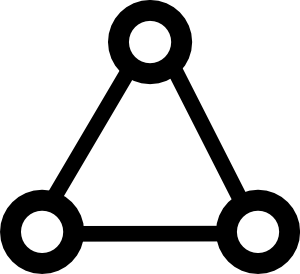

To add upon Yves Daoust's answer, the following graph
Triangle
In this graph, we have 3 nodes and 3 edges, each has the same weight. Obviously any 2 edges will form a MST for this graph. However, which two edges are chosen will depend on not only the algorithm, but the implementation of the algorithm. For instance, if I store the nodes in a list, I may visit them in a different order than if I stored the nodes in a set, even if I use the same MST algorithm from that point on.
In fact, if my implementation relies on pointer arithmetic (which some containers in some languages do), I may even pick a different MST each time I run the algorithm!
