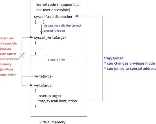

A system call does not necessarily require a context switch in general, but rather a privilege switch. This is because the kernel memory is mapped in each process memory. The user process cannot access the kernel's memory because the memory mapping indicates which part are for the user and which parts are for the system. Thus a system call is really just a change of privilege, not of process. On some systems, like micro-kernels, a system call may involve a context switch because drivers are in a different process. But on monolithic systems like Linux this is not necessary. Linux also supports what is called the vDSO to implement some system calls entirely in userspace.
EDIT: attached a pictureenter image description here
