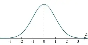

I have a totally random source of signal data that looks like a typical normal distribution. I've included an image as I like pictures:-
normal
The source has a mean of 0, and a standard deviation of 1. It's analogue and therefore of infinite resolution. Very typical.
