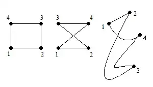

Isomorphism formalizes the notion of equal graphs. For example on this figure you see three isomorphic graphs enter image description here
More formally, an isomorphism of graphs $G_1$ and $G_2$ is a bijection $f:V(G_1) \mapsto V(G_2)$ that preserves adjacency. That is to say:
$$u \sim_{G_1} v \iff f(u) \sim_{G_2} f(v)$$
It is not hard to find such a bijection for every pair of graphs on the picture.
Now if $G_1 = G_2$ then the obtained mapping becomes an automorphism - a isomorphism from the graph to itself.
