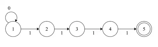

[If I understand the question correctly, this only relates to strings of length 8, i.e. for an automata $A$ we only look at $L(A) \cap \Sigma^8$]
There is a slight variance in interpretation of what a DFA is that plays a role here.
You can construct a DFA with 5 states that accepts $00001111$, but it is not complete, meaning not every state has an exiting transition for every symbol of the alphabet. This quesiton addresses this point in more details.
What this difference in notation allows you to do is skip the sink-node: DFA without sink state
If the input string is of length 8, this automaton accepts only $00001111$.

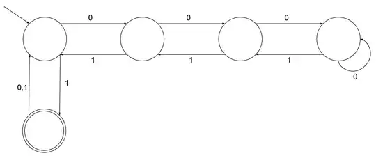

[Note: I'll add this as a separate answer to keep both answers for posterity. This answer satisfies the conditions added later in the question.]
This is a 5-state DFA which, when provided only with inputs of length 8, only accepts the string 00001111:
DFA
(I should also note that I didn't come up with this solution myself. I wrote a quick tool to brute-force through 5-state DFAs to find this one)
