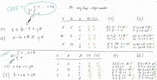

This is another possibility for the "greater or equal" and "lower or equal" version. For the pure greater and pure lower version you must remove the +1 resp. -1 from first constraint. You must also add a +1 to the second constraint "... >= yM+1".
