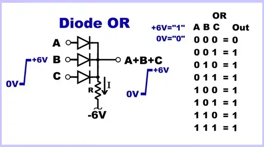

So now to actually answer your question: logic circuits in modern digital computers are non-linear analog circuits where some circuit voltage or current is taken to represent the boolean value. For example, we might say that a voltage greater than 5V represents true and a voltage less than 1V represents false. (Any voltage between 1V and 5V is assumed to be an error).
In the 1950s this was sometimes implemented using diode logic. For example the Wikipedia page shows this diagram of an or gate:
diode-logic <code>or</code> gate by Thingmaker on Wikimedia commons
