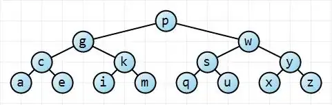

Let's first think about this intuitively. In the best-case scenario, the tree is perfectly balanced; in the worst-case scenario, the tree is entirely unbalanced:
Height-balanced binary search treeWorst-case binary search tree
Starting from the root node $p$, this left tree has twice as many nodes at each succeeding depth, such that the tree has $n=\sum_{i=0}^{h}2^i =2^{h+1}-1$ nodes and a height $h$ (which is in this case 3). With a little math, $n\le2^{h+1}-1\rightarrow h\le\lceil\log_2(n+1)-1\rceil\le\lfloor log_2 n\rfloor$, which is to say it has $O(\log n)$ height. For the entirely unbalanced tree, the height of tree is simply $n-1\rightarrow O(n)$. So we have our bounds.
If we were constructing a balanced tree from an ordered list $\{ 1,2,\dots,n\}$, we'd choose the middle element to be our root node. If we are instead randomly constructing a tree, any of the $n$ nodes are equally likely to be picked and the height of our tree is: $$height_{tree}=1+\max (height_{left\space subtree}, height_{right\space subtree})$$ We know that in a binary search tree, the left subtree must only contain keys less than the root node. Thus, if we randomly choose the $i^{th}$ element, the left subtree has $i-1$ elements and the right subtree has $n-i$ elements, so more compactly: $h_n=1+\max (h_{i-1},h_{n-i})$. From there, it makes sense that if each element is equally likely to be picked, the expected value is just the average of all cases (rather than a weighted average). Hence: $\operatorname{E}[h_n]=\frac{1}{n}\sum_{i=1}^{n}[1+\max (h_{i-1},h_{n-i})]$
