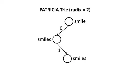

Suppose that we insert the keys smile, smiled, and smiles (in this order) in a Patricia trie. The binary representation of these keys is the following:
Binary representation of the three example keys
Note that smile is a prefix of smiled, and, analyzing the binary representation, we can see that the first bit that differs (from left to right) is 0 (highlighted in red in the second row); for this reason, smiled will be the left child of smile. Similarly, smiles will be the right child of smiled because they share the same prefix up to a bit whose value is 1 (highlighted in red in the third row). The resulting Patricia trie after inserting the three keys is the following:
Patricia trie with 3 nodes

To my understanding, the only difference is the radix, which is equal to 2 in the case of Patricia tries. This value can be any power of 2 in regular radix trees.
Is the difference only in the way comparisons are made when doing look-ups?
In both data structures, the comparison operation is bitwise. However, the number of bits that are checked atomically varies according to the radix. In the case of Patricia tries, bits are compared individually (since radix = 2). This is not necessarily the case in radix trees. In general, bits are checked in chunks of size $\log_2{R}$, where $R$ is the radix of the trie.
How can each node be a "two-way branch"? Shouldn't there be at most ALPHABET_SIZE possible branches for a given node?
The radix establishes the maximum number of children that the nodes of a radix tree can have. For example, when radix = 2, each node can have at most two children. This is the case of Patricia tries (also known as binary radix trees).
