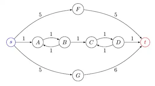

When computing the shortest path from a start vertex to a goal vertex, the optimal path is necessarily simple, i.e., it does not repeat any vertices. However, when computing $k$ optimal paths, the second, third, ... best paths might not be simple. To prove it, I provide here an example that has been slightly adapted from Hershberger, Maxel & Suri, 2007:
The Figure shows a digraph whose optimal solution (from the source vertex $s$ to the goal vertex $t$) is the path $\pi_1 : \langle s, A, B, C, D, t\rangle$ with a cost equal to 5. If paths are not required to be simple, then the second and third optimal paths are $\pi_2 : \langle s, A, B, C, D, C, D, t\rangle$ and $\pi_3 : \langle s, A, B, A, B, C, D, t\rangle$ both with a cost equal to 7. However, if paths are required to be simple, then the second and third optimal paths would be $\pi_2 : \langle s, F, t\rangle$ and $\pi_3 : \langle s, G, t\rangle $ with costs 10 and 11, respectively.
