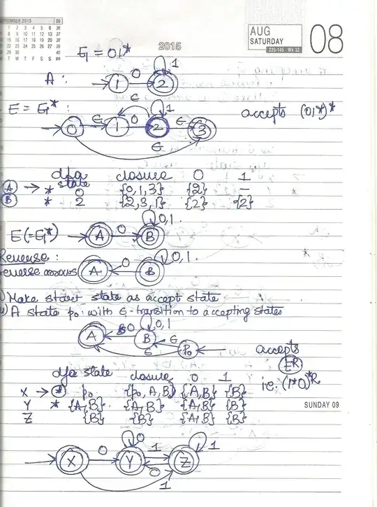

  1. Tried to take up an example, say $E_{1} = 01^{*}$
  2. Draw an NFA that accepts the regular expression $E_{1}$
  3. Draw AN NFA that accepts the Kleene's closure of $E_{1}$, i.e. $E = E_{1}^*$
  4. Convert the NFA into a DFA, and reverse the DFA into an NFA to get $E^{R}$.
  5. Reduce the NFA of step 4 to a DFA again.
This is my work regarding the same:enter image description here

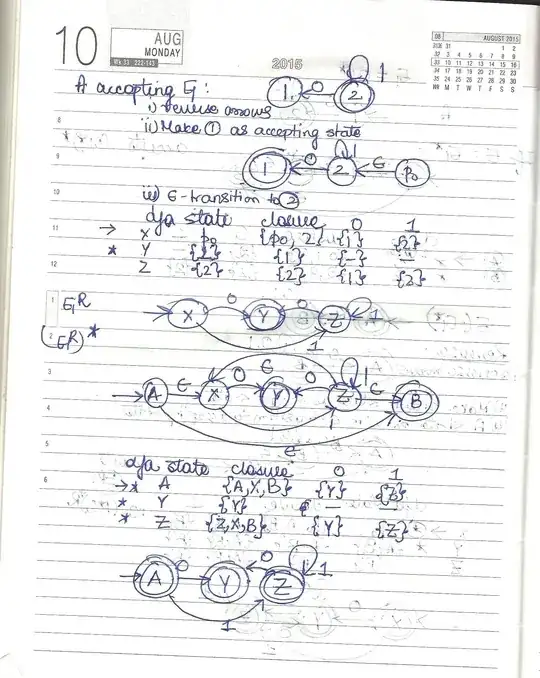

Now for the right hand side, i.e. $(E^{R}_{1})^*$,
  1. Created an NFA that accepts $E_{1}$ and reducing it to DFA
  2. Created an NFA that accepts $E_{1}^{R}$ by reversing
  3. Created an NFA that accepts $(E^{R}_{1})^*$ by taking the Kleene Closure, and then reduced it to a DFA.
This is my work for the second half:enter image description here
However, the two DFAs I get at the end are not similar. Can anyone help me with the error I might be making?

A proof using the definitions of the operators, as given by Yuval, is the way I would also approach this. As for the question of possible mistakes in your automata, there are two:
  • In the first construction, at the very end you mark state $Z$ as accepting, when it shouldn't be.
  • In the second construction, when going from $E^R$ to $(E^R)^*$, you add an $\epsilon$ transition to $B$ from the (non-accepting) state $Y$ rather than from $Z$.
