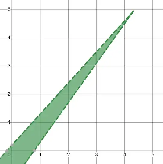

Here is a 2d region where rounding the optimal continuous solution (top right) will always give an invalid integer solution:
1.4x-1.1\ <\ y\ <\ 1.1x+0.2

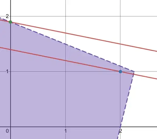

Here is a 2d region where rounding the optimal continuous solution (green vertex) may give you a valid integer solution 0,1, but will never give you the optimal integer solution 2,1 (blue vertex). Maximizing y+5x for positive x, y.
4x-8<y<-0.4x+1.9
