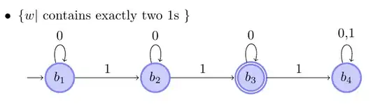

Why does the following DFA have (to have) the state $b_4$?
Shouldn't states $b_1,b_2,b_3$ already cover "exactly two 1s"? Wouldn't state $b_4$ mean "more than two 1s", even if it doesn't trigger an accept state?

$b_4$ is what is called a trap state, that is, a state that exists just so that all possible transitions are explicitly represented, even those that do not lead to a final state.
It doesn't change the language that is being defined, and can be omitted for the sake of brevity.

b4 exists to cover the entire alphabet ([0,1], in this case) for each state. While this is not strictly necessary, it is a hot topic of discussion in the field.
By showing the complete graph, it is more obvious that a third '1' in your input string permanently moves you out of the 'accept' state b3.

The formal definition of a DFA is $M = (Q, \Sigma, \delta, q_0, F)$, were $Q$ is the finite set of states, $\Sigma$ is the alphabet, $\delta$ is the transition function, $q_0 \in Q$ is the start state, and $F \subseteq Q$ is the set of final states. Note that $\delta \colon Q \times \Sigma \to Q$ is specified to be a function, i.e., it has to be defined for all states and symbols. The graphical depiction of the DFA is complete in this sense with $b_4$. Often such dead states are just omitted in the sake of clarity of the diagram, the reader is surely capable of adding them if required.

Answering your question I have to say(sadly) that it depend. It depends on the definition of DFA that you are using because it appears to not be concensus in a unique definition.
For example I use the definition of the DFA where $\delta$ is a function. The next question is: Is $\delta$ a total function or a partial function?
Personally when I use the term function I am refering to total functions by default. But someone can disagree with me. More importantly when I studied the definition of a DFA my teacher told me that $\delta$ is a total function.
Summarizing I use a particular definition of a DFA where the $b_4$ state have to exist. I can skip drawing it for the sake of laziness or clarity, but I know it exist.
Finally to answer your question more precisely we have to know what definition of DFA you use.
Wouldn't state b4 mean "more than two 1s", even if it doesn't trigger an accept state?
The state $b_4$ means that if a word $\sigma$ have more than two "1" it will never reach an accepting state so $\sigma\notin L = \{w\,|\, \text{contains exactly two ones}\}$.
