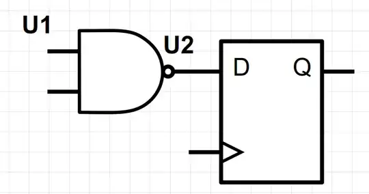

To render things more concrete... Take a two-way NAND gate. Say, I set the two inputs (U1) to high signal, and obtain (after some inherent delay) a stable low signal at the other end (U2). Now, to add basic sequential logic to this inverter, let's add a Data Flip-Flop (DFF). The effect is that we can be certain that the Q end of the DFF will broadcast the low signal "definitively" at the start of the next clock cycle. What happens within the cycle is not to be trusted. The clock period is set such that the other circuitry (NAND gate in my case) has the time to stabilize during the cycle. This is the contract. But how is it achieved?
The metaphor in my mind is that the clock acts as a sluice. But the comparison is misleading, in that the signal entering and exiting the DFF is not truncated at any point. We could physically measure the signal within the tick-tock cycle of the clock at the Q end of the DFF. Another high-flown metaphor would be the warm-up motions of an orchestra before the rehearsal gradually transforming into an attuned performance, with the conductor setting the beat.
How is the proper signal (attuned to the clock's oscillations) distinguished from the noise propagating through gate circuitry at all times? I realize, there may be missing parts in my picture, so that question should be framed in constructive terms: How can one implement this basic circuit to allow the logic to distinguish between signal and noise? gate

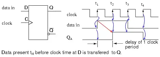

To illustrate, here's a graph of the clock pulse against data-in and Qa output for a DFF.
DFF
Say, in the 2nd clock cycle, Captain Marvel sends a pulse on the data-in line and -- oblivious to the clock period -- expects to read it off immediately (mid-phase). With his lightning speed, there's no way he can make sense of the output of this circuit because the clock cycle is geological time to him. Billy Watson, on the other hand, can read it just fine. Neither Captain M. nor Billy W. is synchronized with the system clock. Not in the sense that the gate circuitry is. But for Billy's experience of time, the clock's time scale is sufficiently precise.

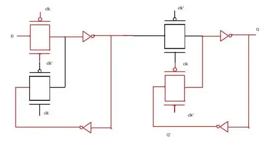

Shown below is a transistor level circuit of the D flip-flop shown in the picture in your post.enter image description here
If you replace your D-ff schematic with the above picture, you can see how the signal propagates from the D input to the Q output.
