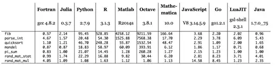

Taking a look at Julia's webpage, you can see some benchmarks of several languages across several algorithms (timings shown below). How can a language with a compiler originally written in C, outperform C code?
enter image description here Figure: benchmark times relative to C (smaller is better, C performance = 1.0).

There is no necessary relation between the implementation of the compiler and the output of the compiler. You could write a compiler in a language like Python or Ruby, whose most common implementations are very slow, and that compiler could output highly optimized machine code capable of outperforming C. The compiler itself would take a long time to run, because its code is written in a slow language. (To be more precise, written in a language with a slow implementation. Languages aren't really inherently fast or slow, as Raphael points out in a comment. I expand on this idea below.) The compiled program would be as fast as its own implementation allowed—we could write a compiler in Python that generates the same machine code as a Fortran compiler, and our compiled programs would be as fast as Fortran, even though they would take a long time to compile.
It's a different story if we're talking about an interpreter. Interpreters have to be running while the program they're interpreting is running, so there is a connection between the language in which the interpreter is implemented and the performance of the interpreted code. It takes some clever runtime optimization to make an interpreted language which runs faster than the language in which the interpreter is implemented, and the final performance can depend on how amenable a piece of code is to this kind of optimization. Many languages, such as Java and C#, use runtimes with a hybrid model which combines some of the benefits of interpreters with some of the benefits of compilers.
As a concrete example, let's look more closely at Python. Python has several implementations. The most common is CPython, a bytecode interpreter written in C. There's also PyPy, which is written in a specialized dialect of Python called RPython, and which uses a hybrid compilation model somewhat like the JVM. PyPy is much faster than CPython in most benchmarks; it uses all sorts of amazing tricks to optimize the code at runtime. However, the Python language which PyPy runs is exactly the same Python language that CPython runs, barring a few differences which don't affect performance.
Suppose we wrote a compiler in the Python language for Fortran. Our compiler produces the same machine code as GFortran. Now we compile a Fortran program. We can run our compiler on top of CPython, or we can run it on PyPy, since it's written in Python and both of these implementations run the same Python language. What we'll find is that if we run our compiler on CPython, then run it on PyPy, then compile the same Fortran source with GFortran, we'll get exactly the same machine code all three times, so the compiled program will always run at around the same speed. However, the time it takes to produce that compiled program will be different. CPython will most likely take longer than PyPy, and PyPy will most likely take longer than GFortran, even though all of them will output the same machine code at the end.
From scanning the Julia website's benchmark table, it looks like none of the languages running on interpreters (Python, R, Matlab/Octave, Javascript) have any benchmarks where they beat C. This is generally consistent with what I'd expect to see, although I could imagine code written with Python's highly optimized Numpy library (written in C and Fortran) beating some possible C implementations of similar code. The languages which are equal to or better than C are being compiled (Fortran, Julia) or using a hybrid model with partial compilation (Java, and probably LuaJIT). PyPy also uses a hybrid model, so it's entirely possible that if we ran the same Python code on PyPy instead of CPython, we'd actually see it beat C on some benchmarks.

I want to make one point against a common assumption which is, in my opinion, fallacious to the point of being harmful when choosing tools for a job.
There is no such thing as a slow or fast language.¹

The bottom line is, the benchmark you found does not make much sense, at least not when boiled down to that table you include. Even if all you are interested in is running time, you need to specify the whole chain from programmer to CPU; swapping out any of the elements can change the results dramatically.
To be clear, this answers the question because it shows that the language the compiler (step 4) is written in is but one piece of the puzzle, and probably not relevant at all (see other answers).

Let's go back to the original line: "How can a language whose compiler is written in C ever be faster than C?" I think this really meant to say: how can a program written in Julia, whose core is written in C, ever be faster than a program written in C? Specifically, how could the "mandel" program as written in Julia run in 87% of the execution time of the equivalent "mandel" program written in C?
Babou's treatise is the only correct answer to this question so far. All the other responses so far are more or less answering other questions. The problem with babou's text is that the many-paragraphs-long theoretical description of "What is a compiler" is written in terms that the original poster will probably have trouble understanding. Anyone who grasps the concepts referred to by the words "semantic", "denotationally", "realization", "computable" and so on will already know the answer to the question.
The simpler answer is that neither C code, nor Julia code, is directly executable by the machine. Both have to be translated, and that translation process introduces a lot of ways that the executable machine code can be slower or faster, but still produce the same end result. Both C and Julia do compilation, which means a series of translations to another form. Commonly, a human-readable text file is translated to some internal representation, and then written out as a sequence of instructions that the computer can understand directly. With some languages, there's more to it than that, and Julia is one of these -- it has a "JIT" compiler, which means the whole translation process doesn't have to happen all at once for the entire program. But the end result for any language is machine code that needs no further translation, code that can be sent directly to the CPU to make it do something. In the end, THIS is the "computation", and there is more than one way to tell a CPU how to get the answer you want.
One could imagine a programming language that has both a "plus" and a "multiply" operator, and another language that has only "plus". If your computation requires multiplication, one language will be "slower" because of course the CPU can do both directly, but if you don't have any way to express the need to multiply 5 * 5, you are left having to write "5 + 5 + 5 + 5 + 5". The latter will take more time to arrive at the same answer. Presumably, there's some of this going on with Julia; perhaps the language allows the programmer to state the desired goal of computing a Mandelbrot set in a way that isn't possible to directly express in C.
The processor used for the benchmark was listed as a Xeon E7-8850 2.00GHz CPU. The C benchmark used the gcc 4.8.2 compiler to produce instructions for that CPU, while Julia uses the LLVM compiler framework. It's possible that gcc's backend (the part that produces machine code for a particular CPU architecture) isn't as advanced in some way as the LLVM backend. That could make a difference in performance. There are also many other things going on -- the compiler can "optimize" by perhaps issuing instructions in a different order than specified by the programmer, or even not doing some things at all if it can analyze the code and determine they're not required to get the right answer. And the programmer might have written part of the C program in a way that make it slow, but didn't make such mistakes in the Julia code -- for example, the order in which elements in a two-dimensional array are accessed might have no bearing on the end result of the computation, but the order might well make a difference in speed (see "Row major versus Column major layout of matrices").
All of these are ways of saying: there are lots of ways to write machine code to compute a Mandelbrot set, and the language you use has a major effect on how that machine code gets written. The more you understand about compilation, instruction sets, caches, and so on, the better equipped you will be to get the results you want. The major takeaway from the benchmark results cited for Julia is that no one language or tool is best at everything. In fact the best speed factor in the entire chart was for Java!
