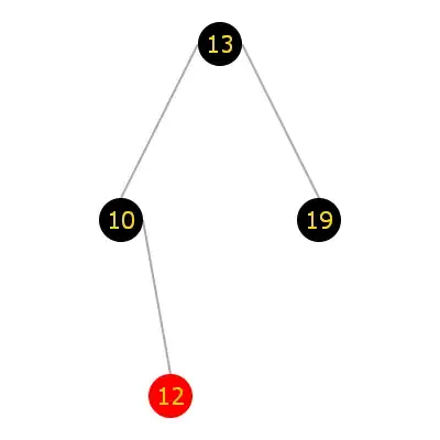

Now adding 12 gives recoloring and comes red.
Red Black Tree elements 10; 13; 19; 12

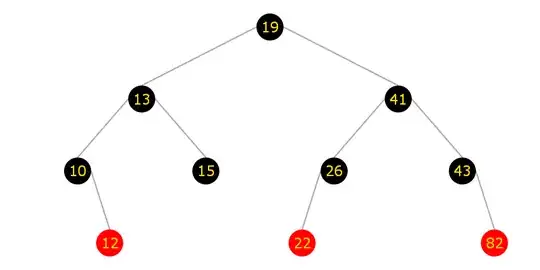

And after several numbers
Red Black Tree elements 10; 13; 19; 12; 41; 43; 26; 10; 82
And now it starts nightmare, as you should propagate changes from one side of tree to another convincing somehow that you will change everything to black after insertion.
