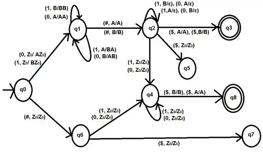

I was told to built a PDA that recognizes the following language:
                 L={x#y ∣ x, y ∈ {0,1}* ∧ x≠y}
See, To approach this, we can have followiing Cases:
Case 1: Let length of 'X' is more than length of 'Y',i.e., |x| > |y|, it should be accepted in our PDA.
Case 2: Let Length of 'X' is less than ;ength of 'Y', i.e., |X| < |Y|. it should also be accepted in our PDA.
Case 3: Let Length of 'X' is exactly equal to length of 'Y',i.e., |X| = |Y|. It SHOULD NOT BE ACCEPTED in our PDA.
 So, to solve this, Let us append an end-marker to the language at the end, which is *"$"*. Therefore our language will be :
              L<span class="math-container">$ = {x#y$</span> ∣ x,y ∈ {0,1}* ∧ x≠y}
Now, Our DPDA can be look like this: DPDA
i have used input alphabet (0,1) and Stack alphabet (A, B). Here "A" represents "0" and "B" represents "1".
 Final States are q3 and q8.
 Initial state is q0.
i hope you can find it correct!
