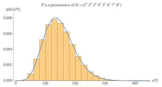

    Below is an empirical probability plot of 100,000 samples of $s(P)$ where $P$ is a random permutation of $\msD$.
    At medium sample sizes, $s(P)\sim \text{Gamma}(\alpha\approx8,\beta\approx18)$.
