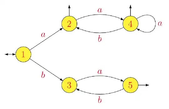

Example. For $L = (a(ab)^*)^* \cup (ba)^*$, we get successively: \begin{align*} 1^{-1}L &= L=L_1\\ a^{-1}L_1 &=(ab)^*(a(ab)^*)^*=L_2\\ b^{-1}L_1 &= a(ba)^*=L_3\\ a^{-1}L_2 &= b(ab)^*(a(ab)^*)^* \cup (ab)^*(a(ab)^*)^*=bL_2 \cup L_2=L_4\\ b^{-1}L_2 &=\emptyset \\ a^{-1}L_3 &=(ba)^*=L_5\\ b^{-1}L_3 &=\emptyset \\ a^{-1}L_4 &= a^{-1}(bL_2 \cup L_2)=a^{-1}L_2=L_4 \\ b^{-1}L_4 &= b^{-1}(bL_2 \cup L_2)= L_2\cup b^{-1}L_2 = L_2 \\ a^{-1}L_5 &= \emptyset\\ b^{-1}L_5 &=a(ba)^*=L_3 \end{align*} which gives the following minimal automaton. The minimal automaton
