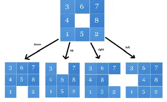

The relevance of the blank space is that a move is encoded by the transition of the blank space. So for example, if the blank space is in the center we have 4 possible moves:
This is what the author is talking about when he says
"2 from each corner for a total of 8 corner moves."
The blank space is what's in the corner. Here's one of the 4 possible corner positions:
As you can see, when the blank space is in the corner there are two possible transitions.
Continuing,
"3 from center of each side for a total of 12"
There are 4 centers of a side and each has 3 possible transitions.
