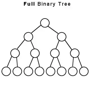

Supposing the algorithm did work in general, it would run in time of $\Omega(2^m)$ worst case, $m$ being the number of variables. The reason is, each splitting of problem into problems of similar size means that the algorithm runs in exponential time. To visualize this concept, look at the following image of a full binary tree (image from here):
diagram of full binary tree
Now imagine the original problem is the node on top. We split the problem into two problems on the second level, but they are of similar size (we only get rid of one variable, $x$ or $y$ from the empty OR implication, so we will still have lots of empty OR implications to do each level). We will potentially have to split the problem $\mathcal{O}(m)$ times to get rid of $m$ variables. This means we will have to deal with a tree with $m$ levels. A tree with $m$ levels has $2^m$ leaf nodes (nodes at the bottom). This is called exponential time, and is informally somewhat on-par with all known boolean satisfiability algorithms. But so is brute force: there are $2^m$ possible assignments of the variables, so by brute force you can guess each assignment and check for satisfiability with similar performance!
