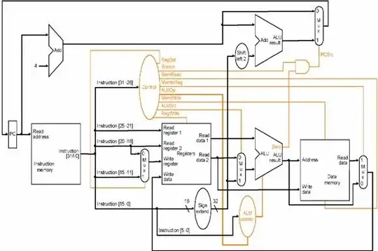

Now you have a myriad of design choices to make. What arithmetic operations does your processor provide? What do your commands look like? It may be educational to look at the MIPS architecture whose early forms are easy compared to other designs. Have a look at the plans:
MIPS single stage
Original from http://ube.ege.edu.tr/~erciyes/CENG311
Essentially, it's fetching and and disassembling commands, a set of registers, an ALU and control. Commands encode which ALU operation to perform on which operands (by the number of the register they are held in), how to manipulate the program counter² or which register to load/store from/to memory³.
