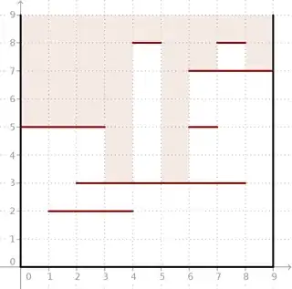

The problem: we are given a two-dimensional square box of side $n$ whose sides are parallel to the axes. We can look into it through the top. However, there are also $m$ horizontal segments. Each segment has an integer $y$-coordinate ($0 \le y \le n$) and $x$-coordinates ($0 \le x_1 < x_2 \le n$) and connects points $(x_1,y)$ and $(x_2,y)$ (look at the picture below).
We would like to know, for each unit segment on the top of the box, how deep can we look vertically inside the box if we look through this segment.
Formally, for $x \in \{0,\dots,n-1\}$, we would like to find $\max_{i:\ [x,x+1]\subseteq[x_{1,i},x_{2,i}]} y_i$.
Example: given $n=9$ and $m=7$ segments located as in the picture below, the result is $(5, 5, 5, 3, 8, 3, 7, 8, 7)$. Look at how deep light can go into the box.
Seven segments; the shaded part indicates the region which can be reached by light
