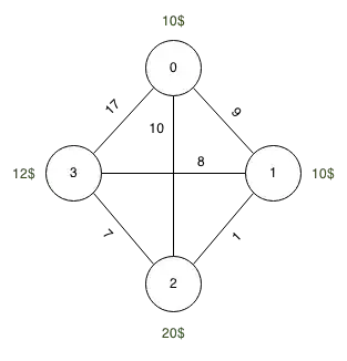

Using @j_random_hacker solution we need to transform our graph to a complete graph and change the condition from equation (4) to:
(c(v) <= c(u) or v = t) and g < d[u][v]
Complete graph should look like this:
and final calculations:
GV[0] = {0}, GV[1] = {0}, GV[2] = {0, 3, 9}, GV[3] = {0, 2}
D(0,0) = min { D(1,0) + 9 * 10 }
D(1,0) = min { D(2,9) + 10 * 10, D(3,0) + 8*10 }
D(3,0) = 0
... etc
so D(0,0) = 170
Path through 0 -> 1 -> 3 [total cost 170$] is the solution. That's what we expected :-). If we need a route, then we should be able to transform those extra edges from the solution to the given edges at the beginning (it shouldn't be very difficulty).
