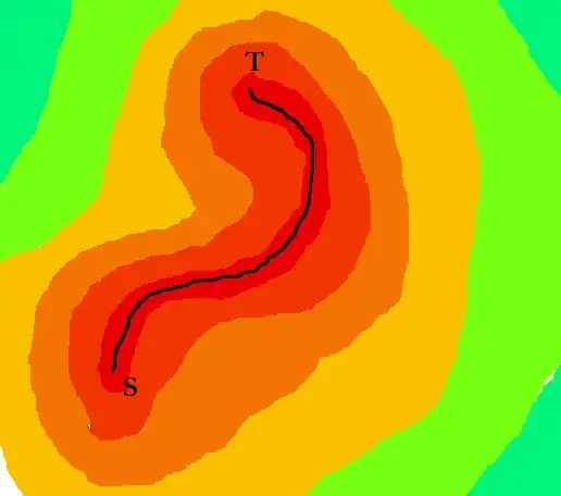

I can't comment yet, so I'll post this as an answer:
Assuming you can find the S-T path with a pathfinding algorithm, why not use the same algorithm with an "antiheuristic" topology?
As you increase the "heat," the further away your found paths will be from your initial solution.
Additionally, you could add some grainy noise wavelets, or random hills and valleys, into the landscape to toss things up a little.
