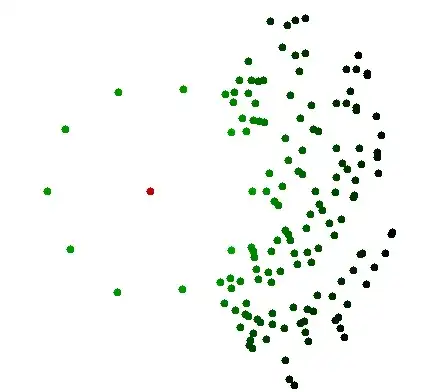

If you've played games like pétanque (bowls) or curling, this should be familiar — you don't need to examine the objects that are very far from the target, but you may need to measure the closest contenders.
To illustrate this point, which green dot is closest to the red dot? (Only by a little over 1 pixel, but there is one that's closest.) To make things easier, the dots have even been color-coded by distance.
a cloud of points
This picture contains $m=10$ points which are nearly on a circle, and $n \gg 10$ green points in total. Step 1 lets you eliminate all but about $m$ points, but step 2 requires checking each of the $m$ points. There is no a priori bound for $m$.
A physical observation lets you shrink the problem size from the whole set of $n$ points to a restricted candidate set of $m$ points. This step is not a computation step as commonly understood, because it is based on a continuous process. Continuous processes are not subject to the usual intuitions about computational complexity and in particular to asymptotic analysis.
Now, you may ask, why can't a continuous process completely solve the problem? How does it come to these $m$ points, why can't we refine the process to get $m=1$?
The answer is that I cheated a bit: I presented a set of points which is generated to consists of $m$ almost-closest points and $n-m$ points which are further. In general, determining which points lie within a precise boundary requires a precise observation which has to be performed point by point. A coarse process of elimination lets you exclude many obvious non-candidates, but merely deciding which candidates are left requires enumerating them.
