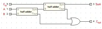

Well, to chain these together, we need to take two half adders and put them together in order to construct something called a full-adder. What makes a full-adder special is that it takes another input, $C_{in}$ as well as the addend and augend, and performs an addition on all three of those bits. Here, the half adder I described above has been put into a "black box" kind of configuration, where the visible details of the circuit are hidden, and the inputs and outputs are provided instead. Notice, just like the half-adder, we have a sum and a $C_{out}$ too.
Full Adder

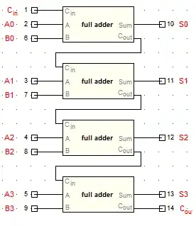

Well, to construct bigger adders, such as four bit adders, we need to chain those full-adders together, and this is when the pattern becomes even more obvious:
4-Bit Adder
And to construct an 8 bit adder, you put two four bit adders together. To construct a 16 bit adder, you put two eight bit adders together. To construct a ... well, you get the point.

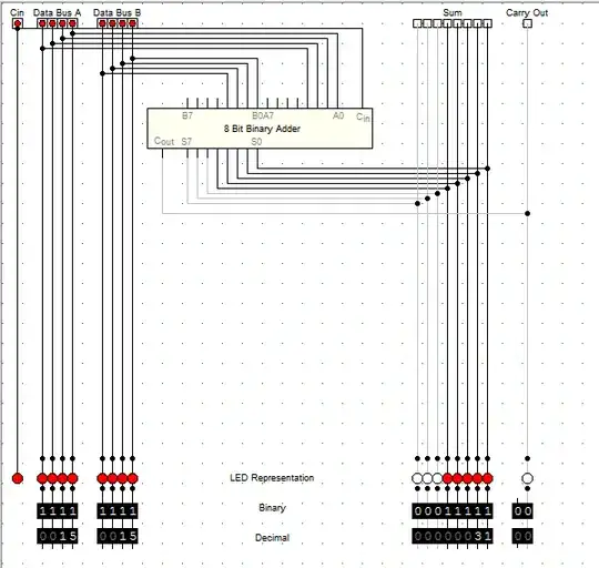

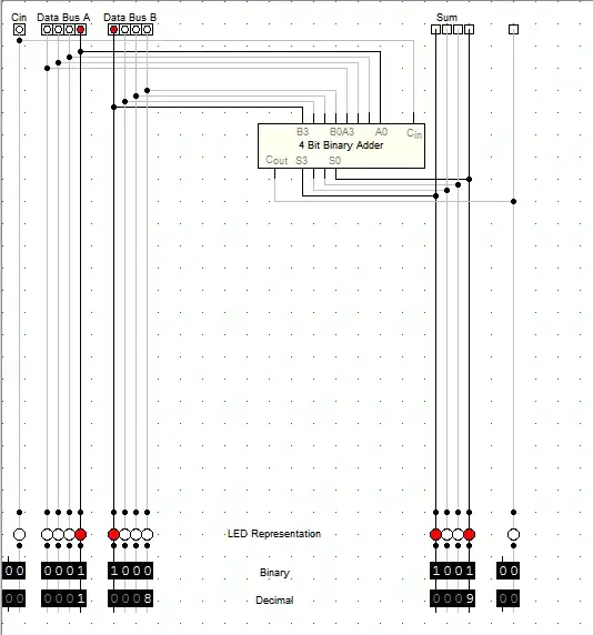

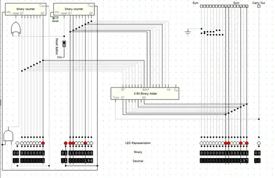

Adder1 Adder2 Adder3
I've added these and I've also made YouTube video of them working, just as I promised.
Videos:
If I get another request, I'll make another video and upload it, showing the internals of what it REALLY looks like as the circuit is going through its cycles.
