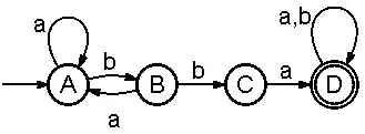

The initial DFA is:
DFA recognising strings containing "bba"

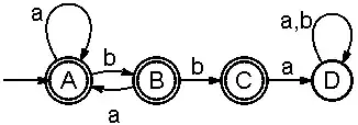

Taking the complement we get:
DFA recognising strings that don't contain "bba"
This second DFA recognises all the strings that don't contain $bba$. Now we convert this to a regular expression using the normal state elimination algorithm. If you haven't seen this yet, it will appear shortly in whatever course you're studying, or you can look over this explanation, but for the moment (and for the sake of keeping this answer on track!) hopefully it's acceptable that there is an algorithm for doing this conversion. In principle this algorithm can result in slightly different regular expressions depending on the order you eliminate the states, so if you have a go at it, you may not end up with quite the same regular expression (if you try one particular order, you get a real mess).
After all that we get the regular expression: $$ (a+ba)^{\ast}b^{\ast} $$
If we then proceed and do the DFA for strings containing $abb$, take its complement and derive the regular expression, we get (picking the right elimination ordering) the same as their second half, $b^{\ast}(a^{\ast}ab)^{\ast}a^{\ast}$, and combine them and get the final answer: $$ (a+ba)^{\ast}b^{\ast}+b^{\ast}(a^{\ast}ab)^{\ast}a^{\ast} $$
