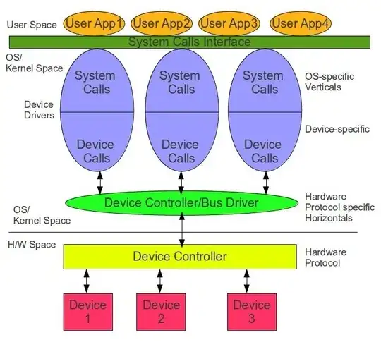

That very, very much depends on the kernel for which you are writing your driver. I'm (a bit) familiar with Linux. There are structures defined into which your drver has to hook. Those structures define most of the structure you are looking for, the driver itself just hooks into the kernel's structures on startup, gets its marching orders through a structure to be filled with function pointers for the relevant operations on the hardware. See Corbet, Rubini, Kroah-Harman "Linux Device Drivers" (3rd edition, get it here). It is somewhat dated, but the fundamentals haven't changed that much. The Linux Drivers Project gathers people trying to write drivers.
For a graphics card, the picture is quite different, I believe you'll find the above split between the kernel and X.org.
(The above general picture, with the kernel defining the overall architecture and the driver filling in the details of what object-oriented programming fans would call an "object" in an operating system defined device type "class" is the only reasonable way of structuring a non-toy, non-one-machine-only operating system. Most of the time written in C, not C++ or ($deity forbid) Java, but OO all the same.)

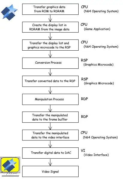

To render graphics, the N64 CPU constructs a display list (GBI command list) and designates the RSP as the processor to use to render graphics. The RSP outputs the resulting graphic drawing into the frame buffer in RDRAM by simply reading and executing the display list provided by the CPU. The accumulated content of the frame buffer is output as a video signal from the video DAC (digital-to-analog converter) by way of the VI (video interface). The following diagram summarizes this process(check N64's Wiki for all of the abbreviations mentioned):

Some more info for further reading (even though it may not 100% help):
RSP(Reality Signal Processor)
RSP is your transform and lighting unit (TnL). Manipulates world data and textures.
Mathematically, lots of matrices to transform from local data -> world space -> view space (projection w/ z-perspective correction).
Transform means scaling, translating and rotating for polygons, lighting normals, texture UVs.
Creates primitive lists of triangles and lines for the RDP to render.
RDP(Reality Drawing Processor)
RDP is the display unit.
Rasterizer, fog, environmental, color blending. Anti-aliasing effects.
Lower-level pixel handler.
uCodes
The RCP has its own language, dubbed 'uCodes' (256 microcodes).
Think of modern vertex and pixel DirectX shaders - both stages combined.
R4000 coprocessor (COP2). Each uCode is a string of ASM instructions run by the RSP. Also sets up the RDP batch renderer.
Display lists are a sequence of uCodes defined by the game. This is fed to the RSP.
Note: Emulator authors choose to translate uCodes into higher-level languages.
The programmers can define their own vertex / texture formats. Lighting methods. Overdraw detection and other flexible wizardry.
The microcodes are uploaded to the RCP at run-time. So each game has its own library of drawing functions (some are like DSP1 -> DSP1A -> DSP1B and others are akin to DSP2,DSP3).
But I'll just go all out here for the N64:
Main 2D Drawing Routine The main drawing routine forms the executing core for the 2D image drawing sample. The process is completed in three steps that are executed over and over in a loop:
Construct the display list in the CPU. Transfer the display list to the RCP for execution. The RCP creates the actual display data and outputs the video signal by way of the frame buffer, VI, and video DAC as previously outlined in this chapter. Keep the CPU and RCP processes in sync, and return to step 1. The following code points to the display list, sets the sprite size, and sets up the loop(all psuedocode):
