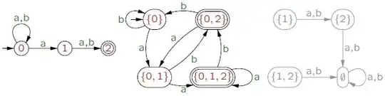

NFA to DFA construction
In the figure we see a NFA (with three states) and the DFA using the standard subset construction with eight states (formal interpretation) or four states (omitting the gray states not reached). (PS. I forgot to mark the final states in the gray part)
