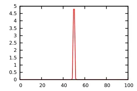

You mentioned time to goal. This is likely not a good target function at all. Why? Because most sequences will not even reach the goal so they will bottom-line to some constant, creating a fitness landscape like this (conceptual sketch in one dimension):
[source]
There are huge areas where the target funtion is $0$. Genetic algorithms are all about signals: small changes in the solution have to indicate an improvement (or decline) in quality if and only if the change is "directed" towards an optimal solution (ideally). If that is not the case (drastically), you have little more than a random search, hitting a good solution with probability near $0$. What does that mean for our target function? It has to be something that improves whenever a solution improves slightly, even if overall quality is still low. So what about
$\qquad \displaystyle \frac{1}{1 + \text{final distance to goal}} + \frac{1}{1 + \text{time to goal}}$
using "infinity" as time to goal if the goal is not reached, that is set the second summand to $0$. As long as the goal is not reached, getting nearer moves fitness up to $1$. All sequences that reach the goal have a baseline of $1$ and improve further the faster they are.
