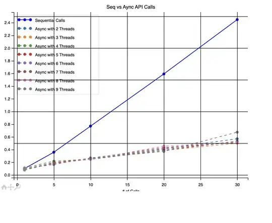

I've used multithreading for speeding up many tasks, but never for API calls. So I went ahead and wanted to make a python code to try to visualize multithreading in API.
Here is the src: pastebin link here
I made it request to my github's page via the githhub api and request 1,5,10,20, and 30 times so I can get more data. I made it run for 1 through 5 threads to see if the number of threads impacted performance.
The result is expected as when running I/O tasks, you don't have to waste time waiting for every single request to complete.
